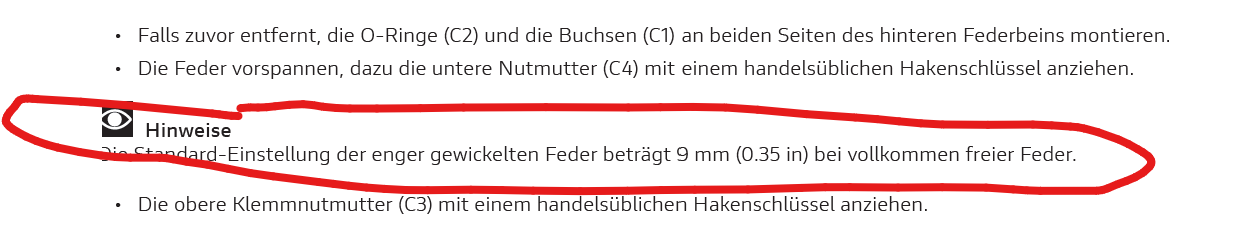

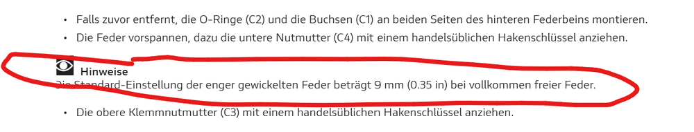

MiHu Posted January 17, 2025 Author Share Posted January 17, 2025 Mir viel da doch noch etwas ins Auge, was ich nicht verstehe. Das "alte" Maß betrug ca. 36mm. In der Anleitung stehe 9mm? Evtl. on top gemeint? Quote Link to comment Share on other sites More sharing options...
Keksvernichter Posted January 17, 2025 Share Posted January 17, 2025 (edited) moin, guckst Du hier (Seite 22 ziemlich mittig) Edited January 17, 2025 by Keksvernichter Quote Link to comment Share on other sites More sharing options...

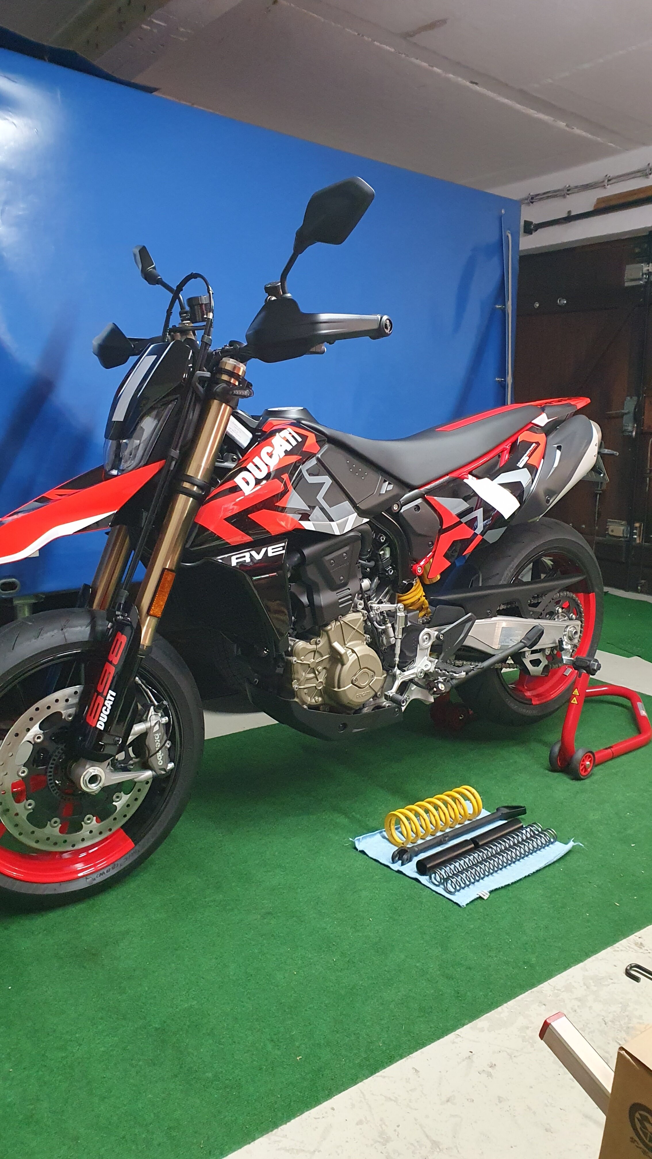

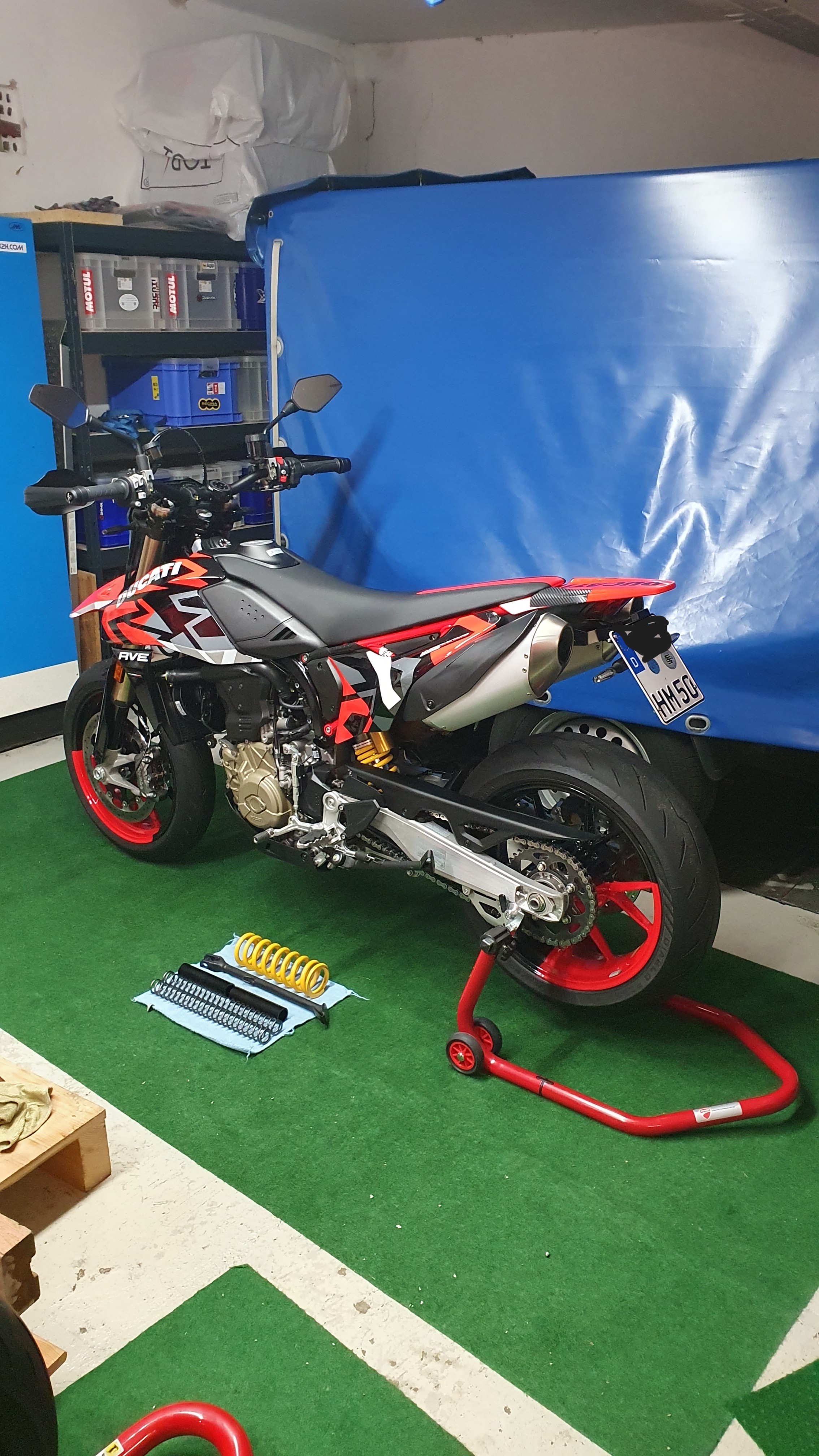

MiHu Posted January 18, 2025 Author Share Posted January 18, 2025 Alles eingebaut. Bin gespannt auf die erste Probefahrt. 1 Quote Link to comment Share on other sites More sharing options...
