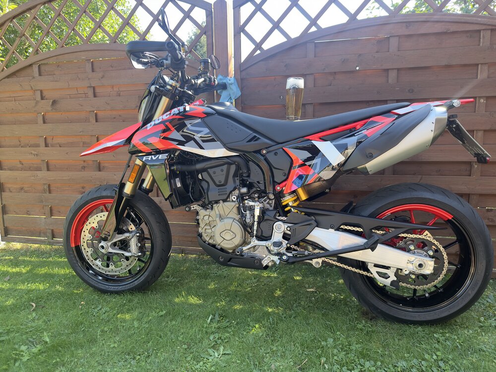

BetterCallSaol51 Posted September 8, 2024 Share Posted September 8, 2024 🍺 2 Quote Link to comment Share on other sites More sharing options...
